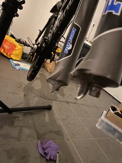

All I wade into this conversation having just fitted a Swytch kit to my favourite mountain bike, I simply followed the marketing and wanted to keep my early 2000’s specialised Epic MTB on the road , it fits all bikes they say , no issues … I rode it for about 10 minutes on mixed terrain before this happened , the front dropouts snapped

Yes! There is an issue here , devil is in the detail - I have just experienced this with my Specialized Epic MTB - not a low quality bike , but not designed to have such forces applied to the front fork.
Without being able to see a real close up of the snapped forks, my question would be:
Was there already a crack/some damage there?

Doxup
Active Member
Ah, but did you break both crankarms at the same time?????
Yes both snapped together, I will share the photo if I’m allowed to on here , the bike is 15+ years old and I have been riding it most days whilst living in Germany over the last few years I’m unable to say whether there were any cracks in the drop outs before.
ExBrit
ExBrit
Yes, I can see both your dropouts failed. That's what makes me think the motor is to blame. If only one had failed, we might consider a pre-existing crack was partially to blame. So I pointed out that both your dropouts failed but only one of Kell's crankarms failed. Do you know if your dropouts are steel or aluminum?

Doxup
Active Member
From research I believe the dropouts are an Aluminium / Magnesium alloy and very old, they use Magnesium to reduce weight as far as possible but it is prone to cracking under excess stress. The bike was never designed to have that load on the front wheel. From further research I’ve found that I should have also considered installing a torque arm to spread the load ( Note: I didn’t know this at the time as the Swytch kit manual makes no reference to this option)
I’m considering buying new suspension forks which are E-MTB certified and then installing a torque arm on both sides to prevent this happening again… but obviously I’m very scared that I will never feel confident with it!
I think that's a very important point. People are saying this probably would not happen with quality steel forks. Thanks for the feedback. I would be nervous too.
Kell
I think if you buy something designed for the motor, you'd be OK.
Like mentioned before, there may be some torque acting on the front dropouts under normal (pedal powered) operation, but they were never designed to cope with housing a driven wheel.
I guess it's the opposite problem to when you install disc brakes on forks that weren't designed for them, you'd need to put the torque bars on there too.
