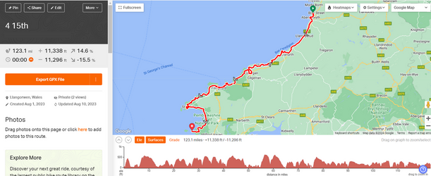

In my experience Ride With GPS is good at indicating paved/unpaved bits, what it's not great with is gradients (although that may not be unique to RWGPS). For my Wales ride last year I mapped out the routes so that I wouldn't be going up hills greater than 15% but by the end of the first day I was fairly certain there had been steeper than that, at the end of the second day there were three signed 17%'s in a row and throughout the rest of the week there were plenty of +15%'s a few 20%'s.
I assume because I was on alot of B roads and country lanes that RWGPS simply didn't have the information.

Ha, that thread was less than a month before the off, wish I read it beforehand. 😅
Day 4 was probably the most spiky. I did not trust RWGPS's 14.6% max by that point.
