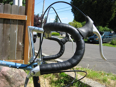

Galaxy Build update
I have finished building the Galaxy up now. I took it out on a ride tonight after assembling all the bits and it was great. Nice and quick, a very different kind of ride when compared to the hybrid.
I sourced the remaining spares through Ebay as the LBS was pricey and could not give me the exact spec on the wheels.
I have only one problem. The frame came with a Sachs Huret Rival Touring Derailleur which I have cleaned up and which is working well, but it is only able to select 7 out of 8 gears on the rear cassette using a 6 speed shimano stem shifter in friction mode.
The derailleur can reach all 8 gears when I push it over by hand, but it seems that the stem shifters are not pulling enough cable to get to the 8th gear?
Is the problem the 6 speed stem shifter in friction mode or is it the derailleur which is about 20 years old and was designed for 6 speeds?
Will a new derailleur eg Shimano TX31 Tourney Derailleur 6/7 speed work? The reason is that they are on special for £6 at Halfrauds and I can pick one up tomorrow and use it over the bank holiday weekend.
Is there a difference between a 7 speed derailleur and a 8 speed one?
I have attached pictures of the rear derailleur and of the finished bike.
It has Shimano RSX 52 / 42 chainset, HG50 chain, 8 Speed HG40 11 - 30 rear cassette.

Rear mechs are usually OK with any number of different numbers of speeds. You just have to get the cable pull right for the indexing (or use friction setting as you have done). The limiting factor with old mechs is often the amount of sideways motion but it sounds like you have enough of that, so I suspect those shifters just don't pull enough cable. Unfortunately stem shifters faded out before cassettes with 7, 8 & more speeds took over from freewheels.
You could try a new derailleur though because the "gain ratio" (amount of sideways travel per mm of cable pulled) may be slightly higher on a more modern mech. For £6 it's got to be worth a try!

On my way way to halfrauds now to pick one up. I hope that the new derailleur will sort out the problem of 7 out of 8 gears.
I went out on a quick 15 miler this morning. It was great, although the rain brought the ride to premature end as I could have done another 15 miles... I love the different positions available on the drop bars. The bike is definitely quicker as I had my brother working hard to keep up with me on the new bike now as apposed to my hybrid.:wahhey:
The ride position is much further forward and lower and the BB is closer to the ground, I must remember that when cornering. As for selecting the gears at the back the stem shifter was a breeze, got it sussed within about 5 miles. Front derailleur changing well too.
I had to stop a few times to make small adjustments to seat height and front derailleur alignment. I have had great satisfaction from doing this build and would recommend it to anyone who wants a project and has some spare cash lying about.
