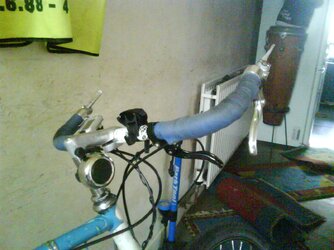

My current bars:

Default position is what I have right now, it's the equivalent to being on the hoods of drops; but I want the cross bar higher, partly to stretch and partly to be more visible when necessary.

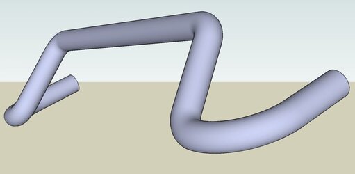

This design suggests an 'in between' position: the almost vertical below the cross bar, this may be good for pulling?
