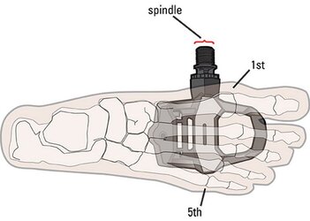

It depends what set up neutrally means? If the cleat is set up neutral to the markings on your shoes (if you have them) that's not necessarily neutral on your actual foot.
The pedal axle should run between the ball of your big toe and the ball of your 5th (little) toe, see image... Some people have a preference to be more on the toes or a little further back but this is the neutral position to start with. Any adjustments made you shouldn't really change until you have a good few hundred miles under your belt, unless you have severe problems. Any adjustments no matter how minor take time to readjust your body/muscles/tendons.
Numbness can also be caused by many other factors, shoes too small/big, incorrect fore/aft position, saddle too low, etc so it may not be just down to the cleats....
