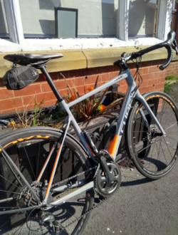

Chainset done for ?
Adam4868
Adam4868
That's because it's a compact and the big ring is small anyway. :whistle:
Lovely expensive hollowtech chainring though ! :ohmy:
Said bike...I think I've had it since around 2018,maybe 19 and bought second hand.Still on original parts so not done too badly.

@Ajax Bay will the worn front chain ring damage new chain if it's not jumping about ?
Mine was looking fairly similar to yours, and when I changed the chain for a new one, I found it was jumping and skipping quite a lot.
To the extent I really couldn't start off in the big ring, it would usually drop the chain.
Replaced the chainset (105 - not cheap!), and haven't had a single skip since. The old one had not been skipping with the old chain.
No, the wornish chain ring will not cause any wear to the chain.
I will try to find a thread (and add it as an edit here) which deals with what causes wear to what,
Edit: https://www.cyclechat.net/threads/why-a-worn-cassette-cannot-damage-a-new-chain.255700/
but the main ' wear chain' is:
Ride chain, chain elongates as pins wear - main occasion of this wear is when the chain link at the top of the sprocket under tension articulates to 'straight', and a much lesser proportion at the top of the chainring (far less angle of articulation). Dirt makes chains wear faster.
Elongated chain starts wearing cassette (because all the load is taken and then 'slid off' by the top tooth on the sprocket)
If chain replaced before 0.7% (say) - mine take about 2500km to get there - then the cassette will not have worn much and will be happy to operate with another chain
And repeat (3 chains per cassette is 'reasonable')
Or don't replace the chain, and let chain and cassette grow old in style
Either way, the sprockets' teeth wear - eventually you'll get skating on the most used sprockets eg 16t
Replace chain AND cassette together
Ride on
After 25000+km (Edit: YMMV) the most used chain ring will wear and need replacing.
