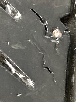

I’ve just had a wheel off the ’free Corsa’, as it’s had a slow puncture for a couple of years (given the (very low) mileage covered annually, it wasn’t an issue
I dumped it in the pond (no fish in it!), & held it down
There’s a carpet-tack in it
I’ve looked at it constantly for those past 2 years, but never seen anything (even when on hands & knees)
Still, it’s satisfied my curiosity that it’s the tyre & not a faulty wheel
IF we do insurance/get VED on it, it needs new tyres anyway, as they’re greying & cracking
Even worse, the cord seems to be showing!!!
(original set at 12 year old)
EDIT @ 20:27
It's not the 'cord', I was going from a photograph that I took & it was the wetness shining
When the tyre was inspected a few minutes ago, with a torch, there's no 'cord' exposed
