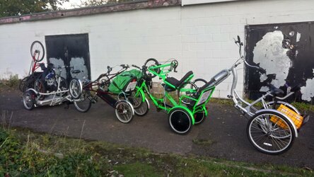

Below is an example of what I regularly ride with

Here is an example of what I regularly ride to events with the charity Leicester Wheels For All which I mentioned above. I and others have been doing it for about 3 years and no problem with the police, mostly drivers enjoy seeing the bike trains it seems (sometimes there are 2 or 3 of them) - something different on the road! Photo is after just having returned from an event.

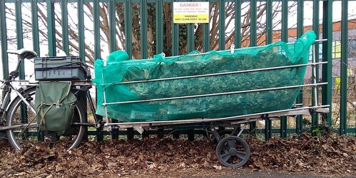

Since volume has been mentioned several times, this is probably the largest swept volume I've towed
1600 x 650w x 500h .. 40Kg +
