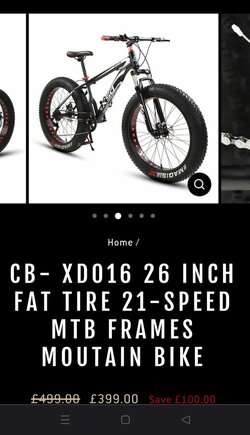

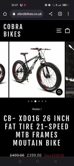

Looking at the Carrera subway I just don't imagine it could take my weight perhaps I'm being overtly cautious but I think it's only right that I am lol, I was looking at fat wheel bikes on a website called cobra this one in particular after correspondance confirms max user weight is 150 kg
The bikes that are most likely to fail will be the same on a Carrera as a fat wheel bike tbh.
Wheels, hubs, frame joints etc.
Carrera or an old Raleigh / Dawes mountain bike.
