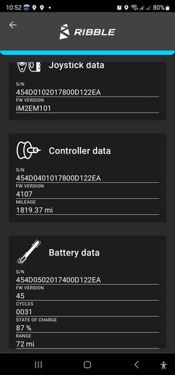

Can anyone here make head or tail of the Mahle firmware numbering? On the website the latest version is Q3.2 (19.9.22) but this number seems to have little relationship to the firmware versions listed on the app. Mine is as in the attached photo. Can anyone having the Q3.2 version installed please post what the details look like in the app.

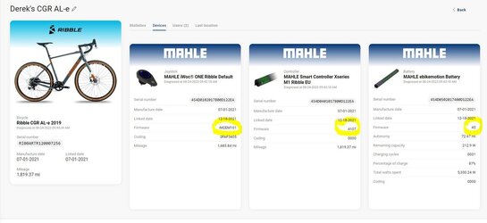

For those who are interested in this... I've been having a dialogue with Mahle about the versions etc and they are either being 'technically thick' or deliberately obtuse! I asked how the Version numbering given in the app and on the my-smartbike website were related i.e if I updated to the latest vQ3.2 from their website how would this be shown in the app versions for controller/joystick/battery shown in the app/website. They though I was talking about App update versions which they helpfully explained had nothing to do with bike firmware (really?!). I've attached a pic of the data from the my-smartbike website.

A quick response from Team Mahle:
'If you update this bike with the Q 3.2 version , you will be able to see the changes in the Joystick Firmware information
Instead of iM2EM101 you will have iM2EM126'
I've asked if the other controllers listed (battery/smart controller) will also be updated but I think they are fed up with me now and haven't responded..

So, after quite a few emails, I have the information I asked for. If you update to VQ3.2 (the latest download from Mahle) the Joystick controller will be iM2EM126, the battery controller firmware will be 4B and the Smart controller will stay the same at 4107 (see my data from the website above). I don't know if this is useful to anyone(!) or if I'm just satisfying my slight compulsion for consistency. Anyway, when I get my GCU cable I will update the bikes and see if the Pulsar One works properly on my bike and if the flashing pink light on my wife's bike stops.
