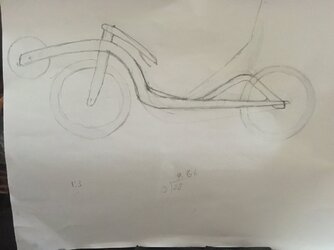

I am thinking of something like this: 2 x20” seat height about 14”, fwd (probably) I could do with some input on this

This might help you with some of the details ...
Raptobike Low Racer – notice the mahoosive front ring !

South wales
Yes, I see what you mean that really is pretty big. I’ve never looked at the raptobike as it’s a 26 20 and I’d always intended going with 20 20 but now you pointed it out I can see it is quite similar to my sketch
