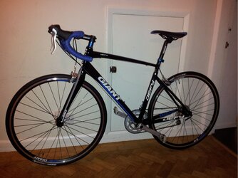

Here it is anyway.

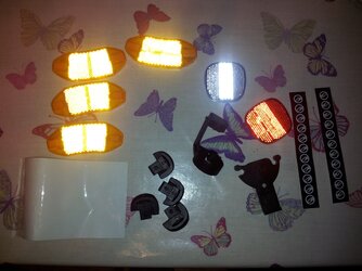

Here's the bits. I get the orange reflector wheel things which I doubt I'll attach. Not sure which bracket is for which front/rear reflectors and where to fix them. There seem to be some mysterious black rubber thingy's marked L/R and some stickers?

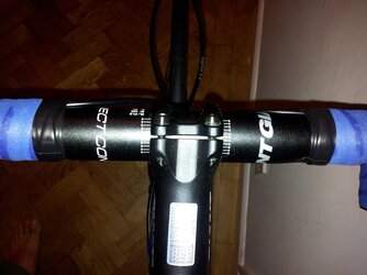

Also have I got this right? The zero is lined up with the middle bit?

the two brackets under the reflectors are for the reflectors ,... the one with the funny looking hooks on ...slide the rear reflector on to the bracket ,it then fits on to the seat rails underneath the seat ...the front one is a simple clamp ,
not sure about the other black bits ...i didnt get them...
the orange ones...wheel reflectors

Yes I knew those silly sticky out bits must have a use except to look mysterious and sticky out....thanks.
So what are the little black rubber things?
They are pad spacers, used to adjust the distance between the brake levers and the handlebars. There should be 2 pairs, 4 degrees and 8 degrees.
If you can comfortably reach the brakes at the moment, you don't need them. If (like me) you have small hands, you should insert a pair so you don't have to stretch as far with your fingers.
Brief fitting instructions and diagrams are on the Shimano technical document (look for "ST-3400 Reach adjustment") - which Winstanleys should have supplied with the bike, along with lots of other information sheets. If you didn't get them, the Shimano site is worth bookmarking.
Great thanks for posting that :cheers: . I didn't get lots of information sheets with the bike, just a generic one which was of little use.
