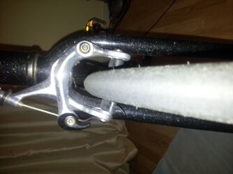

Why is this wheel not in the centre of the forks?
Salford
Just noticed, the front wheel of my (v.v. cheap) SS is offset to the right by quite a lot! (it runs true). I am not talking a few millimetres; it's probably a full tyre width out.
What's up wi' it and how do I mend it?
thanks
Someone has thoughtfully provided you with a sort of dished wheel - not centred in the middle.
It's a reasonably easy LBS job to fix if they have used the same length spokes on both sides.
MossCommuter
Salford
Oh, I see.
Thanks!
Is it a big job? I mean time wise? The whole bike was only £100 new so if it's going to be costly I might have a rethink.
Lean more to the right.
I swapped the wheel for another identical one and it's offset in the same way, so it's the forks (?)
might be something as simple as excessive paint inside one of the dropouts, or it could actually be misaligned. If it's the paint, you can remove it with a round file...
