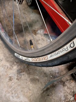

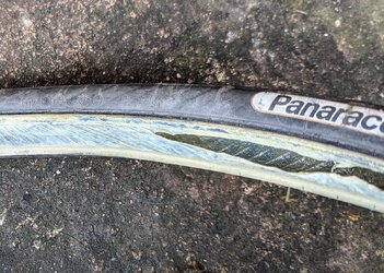

I replaced a worn-out tyre on the Black Hallett yesterday (I could have patched the hole but it was so worn that replacement was in order). As they are big (38mm) thin and floppy tyres I mounted the new one on an old rim overnight so that it assumed its proper shape. The old one came off easily with virtually no mess.
I added a layer of tape as it was looking a bit ragged, fitted a new valve. The new tyre went on without recourse to levers. A blast from the air-shock inflator popped it straight on to the rim. Then I injected sealant, inflated it and spun it on the wheel jig until I couldn't hear any air escaping, and put the wheel back on the bike.

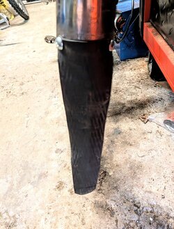

I also refitted the mudflap which I'd torn off by standing on it whilst wheeling it into the garage.
