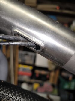

I've now received my new frame from Ribble so as promised a few pics showing the extent of the downtube cracks on my old CGR Ti:
The frame was just under 3 years old with about 11,000 miles on it, mostly ridden on the road but probably with a few hundred gravel miles as well.
I think the bottom right hand crack may have originated from a sharp corner in the welded in cable port surround, causing a stress raiser which eventually gave way causing the catastrophic failure you can see in the pictures. I feel lucky to be alive and undamaged as just before my last ride in the New Forest I checked these cable ports as the screws have a habit of coming loose and I'm certain they didn't exist then, so they must have propagated in the 20 odd miles of that ride. About 1/2 mile from the end of this ride I was going down hill at 29.4mph (according to Strava) so if the cracks had completely gone around the downtube the results don't bear thinking about!

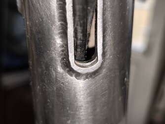

Well I guess it had to happen, the second frame from Ribble has also cracked in exactly the same place and mileage (~11,000 miles). This time I heard (and felt) a 'ping' from the frame and stopped to look hoping it was a spoke or something but nope, a crack it was. A rather stinging email has gone off to Ribble so I'll have to see what they say, I wrote it after a few beers last night (I know, you should never do this!) so it is very uncomplimentary but at least it got over my true feelings!
So if there are any Ribble Ti owners out there I would encourage them to regularily check their frames, especially around cable ports.

Luckily my Van Nich doesn't have internal cables and for a new bike I would chose the same. It seems that these holes in the frame is certainly a weak point.

Out of curiosity etc, I've been doing a few searches for similar issues, and found this, another chap whose CGR Ti cracked around the internal routing holes. Not heard of that particular issue with any other titanium frame brand- including Kinesis, who of course have at least a few reported failures of their own, including on here- and they all offer internal routing as an option if not as standard. A weak point in the Ribble design, perhaps…
