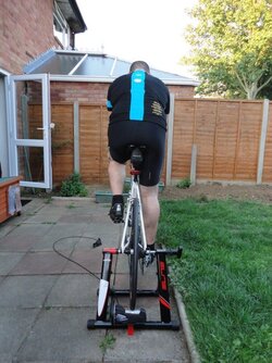

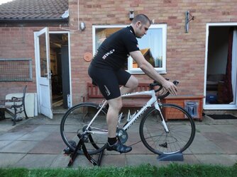

OK, images below and if it helps there's a video clip here:
View: http://youtu.be/EAwRLHQOnyk
From looking at the video I'm now not sure if my saddle is a touch too high?!

Judging by the clip, I would say the saddle is slightly too low if anything - and raising it would certainly level your back a little. Overall, the bike looks 'too short'. A longer stem might help in the short term, together with some longer reach bars perhaps, but I think a longer top tube is what you really need.

Damn!! Certainly learnt my lesson that next time I'll buy from a shop that does bike fitting!!
Looking at the geometry the next size up (58cm) has a 10mm longer stem and the top tube is 17mm longer in the horizontal plane. My current stem is 100mm so I'm thinking if I look for something around 120-130mm?! Is that logic relatively sound?!

Looking at the Allez size guides I'm pretty much slap bang in the middle of 56/58 frame and as I've got gorila like arms (I'm 6' tall with a 6'7" arm span!) I probably needed to go up rather than down.
Certainly a longer stem would be a good start, so yes the logic is sound. I did think your arms looked rather long, but didn't want to say.. ;)
Ultimately, it depends on how flat you want your back to be and/or how much extra reach is needed to alleviate the upper back pain..

Wiggle have got a 130mm FSA stem for just under £25 so probably just order that and give it a go! There was me originally planning to get a shorter one but can definitely see that's wrong after watching the video!

There seems to be a bit much movement in your torso etc; if anything you need to put your saddle up and get a longer stem. Fwiw I'm 5foot 9.25inch and my bianchi is a 55cm and the fixie a 56cm and bike fits have suggested 56cm.
I'll have a go with the saddle up a touch and then change the stem over.
Is it literally a case of unbolting old and bolting on new? Its got a front plate so doesn't look like I need to thread the bars out or anything
