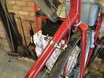

You can screw cable stops on the downtube shifter mounts - the fitting for side pull brake lever stops has the same screw thread.

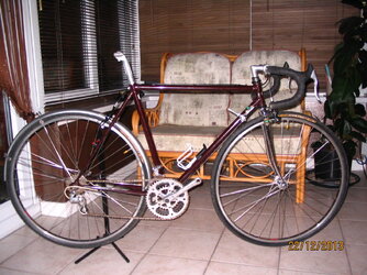

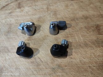

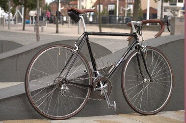

If your Raleigh frame has brazed on lever lugs these are the parts you are looking for, downtube gear adapter/convertors.
Once upon a long ago I used to refurb old 80's Steel as a hobby.
The Dawes in the pic is fitted with Campag 9 Speed Brifters & an 8 Speed Shimano Cassette, takes a bit of indexing, but perfectly do-able, there is loads of info on t'internet just search 'Shimergo' It was a big thing with the Cycle Touring Community about 10-20 years ago which enabled them to add handlebar bags to their drop bar touring bikes.
Pics are a before & after on a Dawes Imperial refurb I did back then showing an old school Shimano 8 speed drivetrain with Campag 9 speed brifters & a close up of the downtube gear adapters.
I've just googled the name of the parts, they're called 'downtube cable stops' plenty available on eBay.
