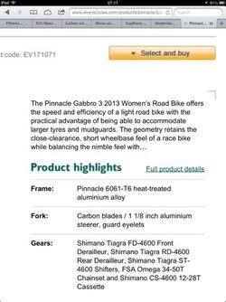

Having puffed my way up some hills yesterday, I was wondering if I should improve the gears on my bike. This is the spec for the 2013 version of my 2012 bike (not sure if they've changed anything from mine except the colour)
Bearing in mind I'm going to try and get up Box Hill and Leith Hill in August, (or at least try and get as far up as possible before I have to get off and push) I'd welcome thoughts. I'm no mechanic at all, so I'd be taking it somewhere to be done, but thought you clever lot would give me some input first.
All feedback welcome, even if just, rule #5 ;)

I can manage Box hill with the same gears you have, Leith hill is tougher though i believe. There is a Tiagra 12-30 cassette available but apparently it might require a new chain.
