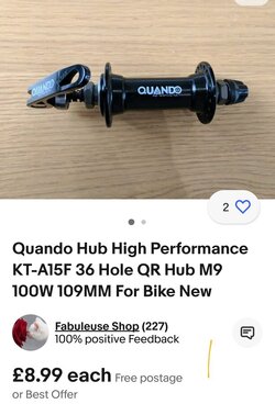

I have a 2012 Raleigh Royal in pretty good nick for £60 that I picked up last year. It is a great bike to ride and very comfortable. I really like it.
It currently has a wheel set on that runs true and appears ok. Quando hubs and stock rims. As it is a second hand bike I have no real way of knowing how many miles it has on it and I imagine the Quando hubs were on it when it was manufactured in 2012. I am going touring in Europe this year and would rather be safe that sorry as I know Quando are not the best.
Spa cycles are doing what seems a nice wheel set with Shimano hubs for £200, but I am open to all suggestions. 👍

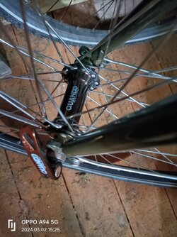

Hi, currently I am running 700 x 35 doublewall alloy rims. Thanks. 👍

I should stick with those Quando hubs, after a service they'll be absolutely fine. If needs be go around the rims with a spoke key.
They are pretty smooth, but to be honest I had never heard of them. Dr Google suggests that they are Chinese and cheap though. I guess I could strip them down and have a look, but to be honest as the Nike cost me next to nothing and is so nice to ride I don't mind treating it. 😁
So have these rims got an ETRTO size on them. I don't recognise 700x35: I think this may be what's on the tyres (not the same as rims). What is the 35? Outside rim width? What width tyres do you hope to roll on? That'd be be my only quibble with the rims @IanSmithCSE illustrated: the Mavic rims are 622-15 (15mm internal width) - not for mounting a 35mm wide tyre on (I have a wheel set with these rims).

There is nothing on the rim. Just plain black alloy rim. The tyre size is 700 x 35.
