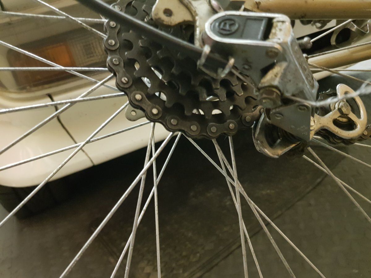

It has its original Raleigh derailleur, but I don't think the last owner got on with it with because the cable was too short or the chain was, judging by the position its in. It changes gear but it fouls slightly.

I’m not quite sure what that means, I’m afraid. I suppose the derailleur might not be the original, which should have the range. In which way does it need to adjust and fit?

Probably is the original derailleur, at least looks like it. Looks like it's lost its adjuster. The block may have been swapped out for one with a lower (bigger) gear.
Thats why the chain is running too close to the big cog as it enters the derailleur causing changing problems. The derailleur can't handle the capacity so you need to change either the block of the derailleur .

Eco never had an adjuster iirc as it was intended for a full outer cable system with adjusters on the shifters.?
raleighnut
Friction shifter, no need for an adjuster you just pull the cable through with everything in top and tighten the clamp up.
Be aware that the top pulley has no sideways 'float' so a botched change can leave the chain sideplates riding on top of the teeth and no drive to the rear wheel, this can lead to an 'undercarriage/top tube interface' :eek: :ohmy:
DAMHIKT but I'd always change gear seated if I rode one now.

So if it’s not missing it’s adjuster, and is the original mech, then maybe one of the cogs has been replaced with a bigger one? And a 28 cog max should go in?

Nah the chain looks too short to me, maybe they ballsed up splitting the chain so had to 'lose' a link to rejoin it (if you pop the pin all the way out it's a sod of a job trying to get it back into the plate)
Try a longer chain cos that looks like a 14-28 rear sprocket to me.

Just checked and the big cog is 28. I just released the cable completely and tried moving the mech but there is barely any give as the chain is keeping it so tight. So yes, I agree that the chain seems too short. The teeth all look in good condition. Didn’t remember it being so loud when it freewheels round though as I turn the wheel.
So I guess a new chain a plate or two longer?
Apologies, not sure about the ‘block’?

'Old Skool' term for freewheel.
