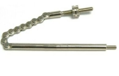

Hi! I've had a Brompton for a few months now and the whole time there has been an issue with the gears. I took it to a repair guy who said the Sturmey Archer 3 speed chain was missing (which he replaced with the one in the pic). With it in place, it does work but will keep unscrewing itself (as in the big rod part is two parts that screw together). If I screw it up all the way tight, the gears don't work and it still gradually unscrews itself - I have to keep adjusting it to be halfway screwed in.
I would just take it back to the repair guy as I'm a complete newbie, but I have warantee from Brompton and if this is a bigger issue I will save my money and bring it up with them instead.
Any advice hugely appreciated! But just keen to know if this is a big weird issue or something obvious that I'm missing. Google hasn't helped :sad:

If I understand your problem correctly, all you have to do is adjust the gears so they work correctly, then importantly nip up that circular knurled nut probably with a pair of pliers or similar, against the female cable end. It might be that that's coming loose allowing the adjuster chain to turn and put your gears out of adjustment

YouTube has some good, simple videos on how to adjust them. They will, or should, end with locking that knurled nut up.

Indeed. with the 3 speed adjuster you've illustrated, once you've found the correct adjustement length, it's important to keep the knurled nut tight against the barrel adjuster screw or it will unscrew during normal use as it's usually under tension. You can do this with a pair of pliers as suggested, but my experience is simply to make it well finger tight.
Works for me. :okay:
tyred
Ireland
I've ridden thousands of miles on various three speed bikes and have always found finger tightness adequate for doing up the locknut. If they had considered tools necessary they would have made it square or hexagonal rather than just knurled IMO.

Tbf, Tyred's comment re the lack of need for tools is correct, its been decades since I had a SA shod bike .
Just make sure its tight in essence.
