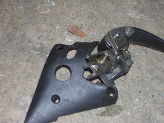

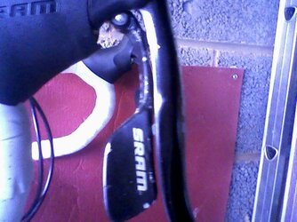

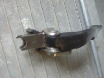

Yes, happened to me earlier this year, when the shifter stopped shifting
The shifter lever has a vertical spring and 'bar' around which it moves. The shifter had fractured at this point, so it was no longer shifting. I hope the attached photos will give a clearer indication of what I mean !
The good news is that SRAM have a 2 year warranty on their equipment. After email discussion with Condor Cycles, from whom I had bought the bike 18 months previous, I sent the whole shifter back and I was able to get a free replacement (after a few weeks). The delay was caused by SRAM wanting to satisfy them selves that it was a genuine claim.
It's worked fine since - and I learnt a lot too !

Cheers Scoosh. That looks exactly the same problem as mine. Its gone back to Wiggle and they have indicated its a warranty claim so I should be OK.
