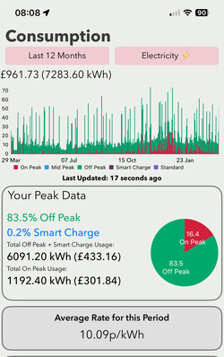

My leccy charges for last 12 months . It’s probably a bit less due to IOG EV charging . What I will say though is that without the EV. I’m not sure we would have saved as much . Having 10kW battery helps with the off peak charging and also for exporting in spring and summer
I expect my usage to drop when and if the brood leave home !!
