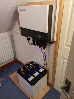

I have three (3.3kw each), they are inside the house in a box room but some put them in the loft. The three of them together are about 45cmx45cmx45cm so not very big
This is a photo of the inverter and batteries
