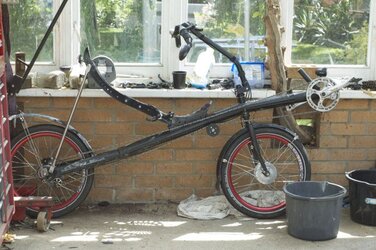

Back to basics?... Try this setup for size (Ignore the frame for a second & look at everything else):
SA 90mm Front drum brake & 3w dynohub (powering B+M lights with stand lights for good day & night lighting without need to worry about batteries).
SA 70mm rear drum & 8sp rear hub
With the 39t front chainring gives the rider a 9.2-29.9mph at 100rpm (31"-100" gear range). Go for a 28t chainring on & you have 6.6-21.5mph at 100rpm which should be fine for a typical utility cyclist.
That 90mm front drum isn't the most powerful in all out stopping terms but can keep the speeds down on steep prolonged descents. The straight chain line without any fuss & a single tensioner works well too.
