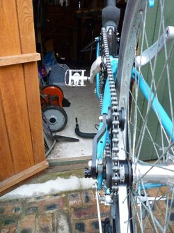

A few pics in the hope that one of you might spot whatever it is that I am evidently missing. The thing that is really confusing me (i.e. seriously annoying me now!) is that the chain runs along the tensioner fine when pedalling backwards - as shown in pic 1 (incidentally, you may notice the pics are with the bike upside down, looking at the drivechain from the back).

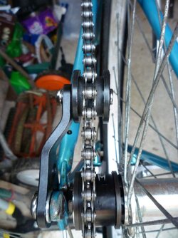

Pedal forwards, however, and the chain runs over to the extreme left of the tension wheel (pic 2) and causes juddering on the plastic side of the wheel.
Pic 3 is attached in the hope it might help in some other way - chain line? I'm using the same chain line as was originall set up by the shopp who converted it originally, and I ran it fine like that for over a year.
SOmething I have just noticed in sorting these pictures out is that the derailleur hanger looks like it might be slightly bent - pushing the tensioner offline, towards the wheel. Can you see that? Maybe that's the problem!
I'm also not entirely convinced by the chainline, despite what I say about the LBS above. In current set up the front chainring teeth 'grab' at one side of the chain - suggesting that (and looking like) the chian runs across them with a bias to one side. But to move the chain to attempt to correct this would be to push it further towards the frame and, seemingly, completely out of line.
I dunno - the hanger bend does look like it mightn't be doing a whole lot of good..!
