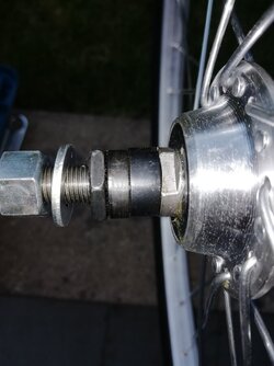

The new freewheel (Halfords) fits fine....Okay the next problem I've got is that on the new wheel, the bike dropout wants to sit on this washer thing with the arrow
. Is it ok to move/remove it so the drop-outs can sit there?
Days ago I advised the OP to measure the distance between the dropouts: what is it (without wheel in there)?
Likely the wheel you've bought is a 130mm OLD which you are fitting into a 126mm OLD dropout. It's not as simple as just removing the 4mm spacer (with which @Paulus seems to acquiesce). The wheel will then fit in but the wheel will be off centre in the rear triangle (which will then mean the brakes can't be adjusted to operate effectively).
Trying to solve that by redishing will not be safe as the right hand side spokes will be at an extreme angle and the left hand spokes will be low tension and liable to actually lose tension every time they pass through 6 o'clock.
The solution is to increase the dropout distance by spreading the rear triangle apart by 2mm both sides.

Likely the wheel you've bought is a 130mm OLD which you are fitting into a 126mm OLD dropout. It's not as simple as just removing the 4mm spacer (which @Paulus seems to acquiesce with). The wheel will then fit in but the wheel will be off centre in the rear triangle (which will then mean the brakes can't be adjusted to operate effectively).
https://sheldonbrown.com/frame-spacing.html
You're right. On the driveside of the wheel, the axle fits nicely in the drop-out, but on the non-driveside, the axle is clinging on to the drop-out for dear life 😆. Rideable, but the rear axle is on the piss.
I'll get a piece of 4x2 and prise it as per Sheldon 👍
