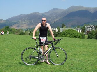

Can you tell us a little about this build please?
philhul
New Member
Newcastle
Can you tell us a little about this build please?/quote]
Indeed. It is either a Carbonzone rb002 or rb003, can't remember which, but it's a FM028 to everyone else. Size 54cm. Finished in matt clearcoat.
Carbonzone 60mm carbon clinchers.
Sram Force Groupset.
Planet X Ultralight CNC Brakes with Ashima pads.
Saddle has changed from the one in the pic to a 114g Token one.
Easton EC90 seatpost, cut down and decals sanded off.
Ritchey wcs stem. Was wet black, but paint and decals removed and nice plain matt black finish left underneath.
Ritchey logic 'bars. Currently wet black, will be modified as above, then replaced with lighter carbon bars at some point.
Planet X matt carbon bottle cages.
Planet X ti and carbon skewers.
Fizik microtex bar tape.
Look Keo Classic pedals.
Currently about 7.3kg. I'm trying to get as close to 6.8kg as I can without having to change the wheels, which are 1.7kg.
Thanks for the nice comments.
Braking in the wet isn't too bad. Definitely worse than in the dry, but as long as you brake a little earlier and you are aware of it then it's manageable. I only try to ride it in the dry though.
What did the overall build cost you out of interest? and specifically the frame and wheels?

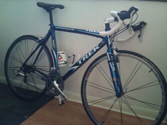

Here's my first Carbon Road Bike, let me know what you think, would really appreciate the feedback :becool:
I think it's absolutely gorgeous! I quite fancy a Focus Cayo, But I'd very much like the Cube Agree if they come down in price in the pending sale at the end of the season.

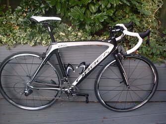

My Orbea Orca classic
Built with SRAM Rival so it has my secret weapon, a 12-28, makes Saintsbury on Sunday less intimidating!
