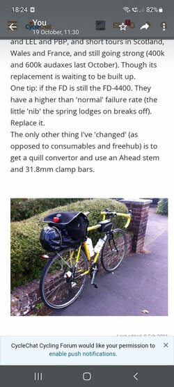

Hi I bought a bike the other day a dawes audax anyway it turned up most of the stuff on there was gone passed its sell buy date. I should have asked more questions what I need to know can I get chainrings for the chainset or should I just use it until its jumping all over the place then buy a used triple like the ones on ebay say a 105 or ultegra There's no marking on the chainrings to say what it is.

mountainash
Here's the same bike.

Juan Kog
permanently grumpy
I’m not disagreeing with Colins idea but you will have to add cost of a bottom bracket as well .
So possibly just replacement rings from Spa
edit my Tiagra 9 speed double is not square taper .
🤔 But if you’re existing B/B needs replacing . Maybe more cost effective to replace chain set and bottom bracket .
Thread necromancy (coming here after the OP's Q about 'racing bikes for audaxs (sic)'.
Thank you for featuring my Dawes Giro Audax, and our hedge! I took this photo immediately on return from an end-to-end. The bike and I have since managed KSW600, Mille Pennines, LEL, WH1000, PBP, five SRs and down to the Med and back (ride/train).
I have stopped using the rack and bag and prefer a smaller saddle bag plus a frame bag (for overnights or rides >300km).
Its Tiagra 9sp triple crankset is still giving excellent service though I've replaced all three rings and the UN-55 BB a couple of time (about 20,000k each BB).
