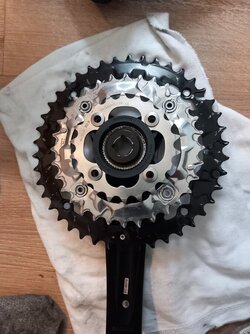

Shimano Alivio chain wheel, chain ring torque bolt settings ?
Gave the bike a thorough clean after a ride this morning, removed chain wheel and cranks and stripped to clean, all in good condition hardly used really I torqued bolts up to 14nm, which I read somewhere should be 12 to 14nm ?
Other Google searches said 17 to 20nm surely this is too much as threads quite fine ?

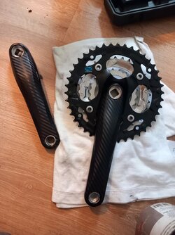

I used some fresh cut strips of carbon fibre wrap and covered crank surfaces with misses hair dryer as my shoes over time wear paint off and leaves an unsightly silver streak 😆

I think the OP was asking about the bolts holding the Chainrings together, not the crank bolts.
Mr Celine
Discordian
The nuts and bolts holding the middle and outer rings to the crank are all steel so unlikely to strip their threads. The usual problem is stopping the nut from turning.
The bolts securing the inner ring to the crank are steel into alloy. I put a smear of copaslip on the threads to prevent them seizing and tighten them as much as I dare, having never found a recommended torque setting.
I'm a bit too gentle though as I have lost bolts from my winter bike and gouged the carbon on my summer bike when the inner ring bolts have loosened.

Looks like I mis-read (though see OP has 'liked' my post this morning).
Echo @Mr Celine 's point on chain ring bolts: the torque (for outer/middle) is always (ime) limited by one's ability to secure the nut with the two prong tool. The inner ring is secured by steel bolts into the aluminium spider, so should be firm but no gorilla stuff.
I always use medium threadlocker on chainring bolts; not grease.
Shimano says 12-14Nm for road and 14-16 Nm for MTB; bit more for inner ring
http://si.shimano.com/#/ DM-GN0001-20-ENG.pdf Page 141
