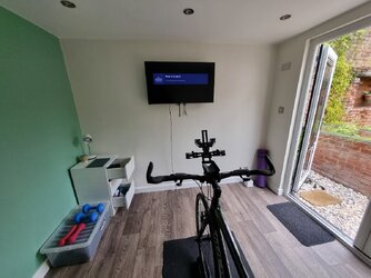

Hi,
I have a 40 inch TV currently on the wall which is far too high for Rouvy etc but I just watch it on the ipad and look up occasionally for a different point of view mostly.
I'm thinking I'd like a much bigger tv for an more 'immersive' virtual cycling experience now they are so cheap. I have two questions;
- Is there such a thing as too big a tv for this set up? The wall is 2.8m wide and the tv is 40inch. The little boy inside me is screaming for a tv as big as the entire wall but I appreciate that might be taking it a bit far and;
- What is the optimum height for the tv for virtual cycling. Should my eye line be level with the top of the tv for example? I'm going to have to remount the tv mount so hopefully the new tv will cover the old holes else I'll need to do some filling.
Any advice from you pro's out there?
TIA
Matt

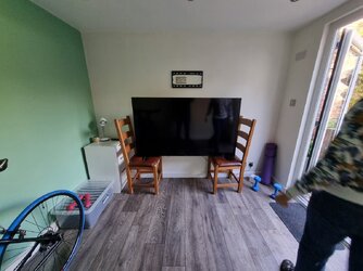

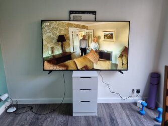

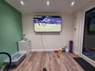

Ok. TV has arrived and I have tried different positions. Top of the tv being level with the top of the bracket feels sort of correct but the screw in arms on the back of the tv don't accommodate that position. What do you guys think? I don't want to get a sparky/builder out just to move the tv bracket down a bit. Picture of tv on original bracket at the lowest setting. it is far too high as you can see.

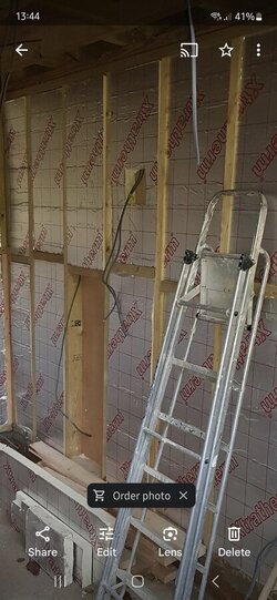

If I could flip the bracket around so the top uses the bottom screws that would probably be the right height but the electrics behind look a faff!

Could you not move the bracket yourself? If it's plasterboard then you hardly even need a drill bit. The fixings are quite cheap from Toolstation
I'm guessing its whether he wants to or needs to move the plug socket to keep it hidden.
The set up on the white cupboard or an inch or two lower looks about right, but you can tell by sitting on the bike and seeing whether it feels comfy looking at the screen that way.
You need to make sure a couple of screws at least go into the joist behind the plaster board, and any that don't use proper plaster board plugs so the whole rig doesn't drop off the wall. At least LEDs are much lighter than the old plasma screen TVs!

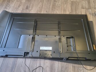

I'm sort of thinking the white cupboard height is correct also but I need to get on my bike really. The wooden joists piece were scaring me a bit finding them if I had to again. Are those the thingies that kid off dragon den invented? But before I try that. I wondered about these extenders. Any thoughts?
https://www.amazon.co.uk/dp/B0B197RHSY?ref=ppx_yo2ov_dt_b_fed_asin_title
One of those extenders will probably work OK. It's metal so should hold the weight comfortably.
Alternatively drop the bracket down a bit - I wouldn't worry too much about the electrics if you run the screws in directly below it should be into joists, and if you have the TV high enough it'll still hide whatever plugs are behind at the moment anyway.

I've not tried the extenders, but they seem pricey for something you don't really need, and presumably the old bracket and part of the extender would still be visible. If you have rear access to the wall then that's even better. Turn off electric at the consumer unit, take out the wires and move the socket box if you need to. Fill any gaps/holes with plasterboard patches and/or filler. For bigger holes you can use a bit of wood backing, there are loads of Youtibe vids on how to do it. Then just move your TV bracket to where you want it. You could get a handyman/electrician to do it but you'll be looking at £60/hour. Or if you're not that fussy you can run extensions if the newly located TV does not reach the socket...and use white trunking to cover up the cables

Personally for a solid fixing. I would cut out a section of plasterboard exposing two vertical studs where the power is already installed. Then with roof battens attached on the inside of the studs, fix a 18/22mm plywood panel onto battens. Make this flush with the vertical studs. Reinstall the cut plasterboard panel, fill in gap. You then have a solid wooden panel to hold the TV bracket. I've done this many times, my favourite tool is a reciprocating saw which makes clean cuts into plasterboard, allowing a quick patch repair.
Example of me installing plywood panel to attach shower fixings before boarding and tiling

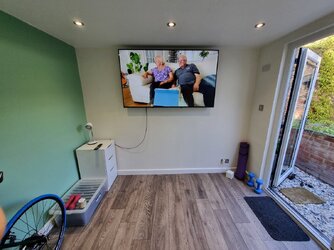

The extenders were tricky as I had to turn them the other way around than the instructions stated in order to see both holes on the tv! Still looks too high for cycling but I'll try later. I'll include the old tv set up pic as well for a comparison.
