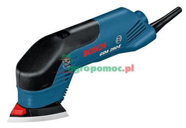

I've used a 1/3 sheet Bosch orbital sander for years. For getting into corners and tighter spaces, my Bosch delta sander has been extremely handy.
BTW, beware! There are plenty of sanders that are pretty useless especially those with multiple accessories.
