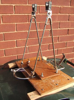

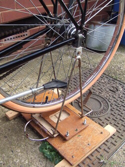

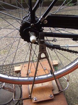

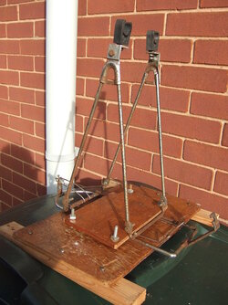

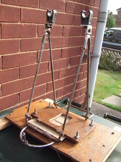

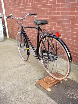

Threw it together over 10 years ago, with the intention of making a better job, but never needed to.
The nylon 'pipe' clips at the top attach under the ends of the chain stays, directly in front of the drop-outs.
Keeps the bike vertical, is reasonably stable and doesn't scratch anything.
Doesn't interfere with the SA clutch chain and allows the wheel to be removed, the gears to be adjusted and supports the bike while most jobs are attended to.
Cost £0.00
