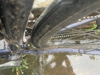

As feared on https://www.cyclechat.net/threads/r...art-6-1-700-miles-its-a-good-tool-but.296599/ the motor cable is not up to to job in this location. It went from untouched to this in one commute round trip (40 miles). It seem to be a combination of a changed freehub, a couple of loose spokes and lots of snow.
Sadly I have an earlier model battery where cable replacement is not intended to be performed by an end user. Sent back to Mahle it might be possible but whether it would be worth the cost and effort is a different matter.
So potentially I am 11 months and around 6,500 miles in and need a new £650 battery pack. This is currently under discussion as I am asking for a new battery at around £300 as I am about halfway through its life anyway.

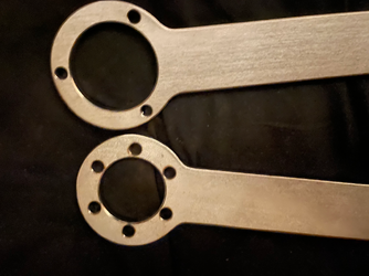

I have mentioned elsewhere the need to replace the freehub, which came in at £140 including a couple of spanners. An important lesson from this was the high degree to which the ebike retail sector is saying we are not interested if you didn’t buy the bike from us and Ribble aren't carrying spare parts.

The cable issue isn't ideal, but this issue of a rubbed bike can happen if you've loose spokes and going through something that can cause abrasion. I lost a fair bit of paint on my CX bike when we hit a tonne of sticky chalky mud - so bad it clogged the at forks and rear chainstays - carrying on scrubbed paint off.

The thing is Ribble (or their) frame maker chose to run the cable along the inside of the chainstay rather than underneath it.
They actually riveted cable clips to the inside of the chainstay, so it is not a case of zip ties that slipped and the intent was to have the motor cable run under the chainstay.
I always had concerns about this but there is a strain relief gromet where the cable enters the seat tube which is so tight that I initially decided not to try and move the cable to run under chainstay for the fear of causing damage.
Because there were cable clips riveted to the inside of the stay I thought well it's probably safe and the cable can take any rubbing it might get.
It may not be clear from the photo but the inner conducting core of one of cables is exposed to the air, white wire, and the yellow wire is only a few miles away from also being exposed and then the two possibly shorted. It is not clear to me if these are data cables or power cables, shorting the data cables would be sad, shorting the power cables may be a very bad idea, hopefully nothing would catch fire. :smile:
The newer batteries allow the replacement of the cable between the battery and the motor, but the older batteries are a sealed unit. at least as far as most customers would be concerned.
There is a youtube video where someone dismantles the battery unit, which shows how difficult replacing the cable is. :-(

The cable routing on my bike is very tight in approx the same place, but it's slightly more forgiving as I was able to move them around to outside the mudguards and out of harms way.

I did get the hub and tools so they are available so it seems that Ribble doesn't want to stock them, but I was told a by a number of retailers that We only sell or support customers who bought their bike from us.
X35 is probably getting to the end of its life and maybe Ribble are trying to avoid a stock of parts they will never be able to sell or use but these are all advertised today as being X35 rather than the newer X20 and aren't obviously cheap for a reason.
I did wonder if the reason they don't stock the freehub is to avoid the awkward question of okay how do I fit it, Oh sir, you need to spend £70-£80 on a pair of spanners that you might only ever use once.

You might have to bite the bullet and get the tools to maintain a freehub. If it's cartridge bearing, these are serviceable. It's an issue with parts that aren't 'standard'.
