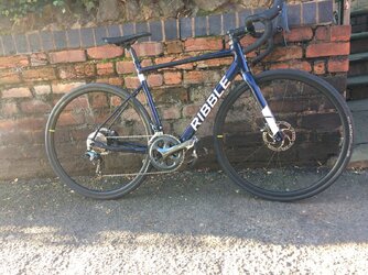

I think that I have worked out the reason for my disappointment.
I fully charged the battery at work and after the ride home the prediction is around 150 miles per charge on a Mahle X35 with the 250Wh battery and no range extender.
Before I got the bike I was expecting to have to charge the battery every day as the range wouldn't be enough for 2 days, now it is looking like it could almost make 4 days.
In other words the motor is off most of the time.
When you consider that this is a commute with a number of stops and starts where the motor will be active, the bike is the best part of 8lbs-10lbs heavier than what I am used to and it does do some work on the hills all is becoming clearer.

Looking at the numbers on the screen shot you seem to be riding at a similar pace to me.
Most of the stuff that I have been reading talks about 60-80 miles on a charge, half of what it looks like I will be getting, so the assistance level for those poster would be double.

On my Raleigh the bottom gear is 38x28 (8 speed) and on the Ribble it is 34x32 (10 speed) and yes on the very steep stuff I can feel the difference, but this probably covers 500 yards in 18 miles. :-( Although I am not high speed spinner I am happy at 90 and a bit RPM and I suspect that the massively lower gears simply spin me out of the power band on the rest of the hills.
Oddly there is a stop, followed by a false flat on a terrible road surface for a couple of hundred yards and I really noticed the motor there as it has always been harder than it looks like it should be.
I will look again at the rear wheel spin later today as brake performance is definitely improving/wearing in.
