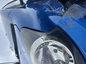

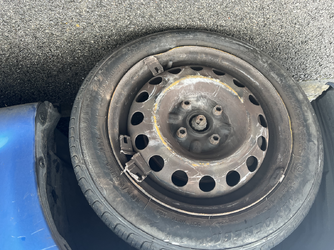

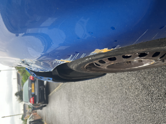

So we have a 10 plate , Aygo , 66K on clock , 2 owners from new, and dealership FSH. It's never really put a foot wrong and never had any major problems.
Earlier the week Mrs 73 had an accident in the car luckily no one hurt and no other cars involved. Minor damage to someones garden wall which we've arranged to sort out.
We've taken the car to local body shop owned by a lovely bloke been doing it years who we've used before. He looked it over and said the best thing to do is make a claim and write it off given it's age. His worry was due to side impact on the wheel and possible underlining damage.
The insurance company have said it's beyond economic repair and arranged for an engineer to phone us on Monday to go though everything.
Never had to deal with insurance before or things like this. Just don't want to be rushing in and buying another car and ending up with a lemon.
Only dealt with big dealers before but with our budget now thats not possible.
We are going today to look at one , same age as ours , 107 , FSH 32K on clock only difference is it's 3 door.
So do we write it off or forget the insurance and repair it using what we have to spend on another car ?
Other than the body work having driven it I do know the suspension is not right and it's slightly veering to the left.

I know the model well. The insurers will most likely be basing their decision on a financial model rather than one of the appropriateness of a safe repair.
The bumper and wing are bolt on panels. Grab the Haynes manual (there is one) and remove them.
It'll then be very quickly apparent if there is any damage to the understructure of the car.
If anything under there is remotely bent, bin in.
If all is straight the likes of ebay will see you with a new wing and bumper for minimal outlay. You'll then be able to get both painted in the correct shade for around £300, and then bolt them on. Assuming nothing structural is damaged you're looking at about 3 hours work to remove the old and refit the new. It all comes down to whether you want the hassle, or would rather just taken the money and run for the sake of an easy life.
Insurers use expensive body parts - this is one reasons why the cost of insurnace has been going up so much
If you do it privately then you can use panels from cars that have been scrapped due to damage in other places - which could be much cheaper
Put - as said above - if anything other than simple panels is bent then it needs an expert to assess it
Oh - and if the insurance company are involved and decide to write it off then if you repair it then it becomes a category D (or something) which reduces the value when you eventually do sell it
although at that age it doesn;t have a lot of value left anyway

The bodywork is just cosmetic. More worrying is your statement that it isn't driving right after the accident. Tracking might be knocked out everyone will say, but tracking doesn't just get knocked out, something has to move/bend. It might be something simple or it could be something serious/dangerous. Inspection by someone professional/knowledgeable definitely required.
Cycleops
Accra, Ghana
Unless you're an expert on accident damage and repairing it like Samcrac or one of the other amateur YouTube whizzkids give it a miss. Something obviously amiss with steering and that's something you need to be sure about.
If just cosmetic give it a go with second hand panels but looks like it isn't.
