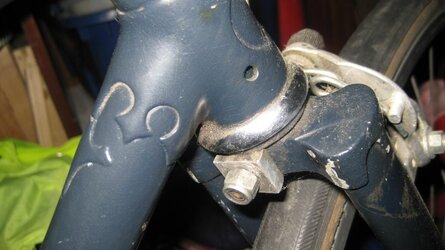

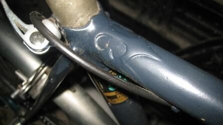

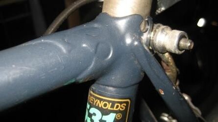

Old Holdsworth lugs... suggest it's a 1950s 'Cyclone Deluxe' Road Frame as that was the only frame these special spearpoint lugs were used on.

She was in a far worst state than yours when I rescued her from a garage for £5 in about 1982. Cheap re-spray job and replaced all the steel bits withn Alu (except seat post) and still have the original Mafac 'Racer' brakes. Crudely converted her to fixed around 1984 and apart from a brief fully-loaded cycle-camping tour of France she's remained a fixed for most of her life. Now mostly a turbo-mule due to the fact that in the last few years the forks have grown quite a twist! I must really get some new ones.
Lovely ride though, just sweet. But the frame is sooo beaten!
