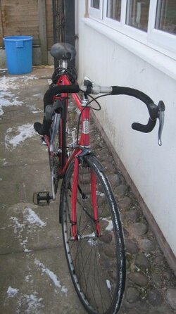

Front view of the bike

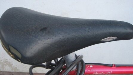

view of the saddle with the tear visible

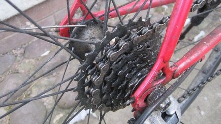

rear mech

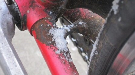

bad bit of rust and flaked paintwork and the base of the seat tube

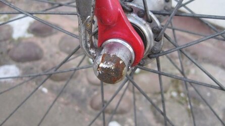

front quick release

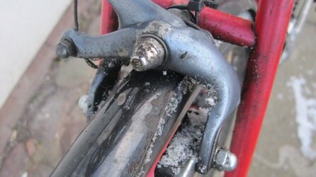

rear brake assembly

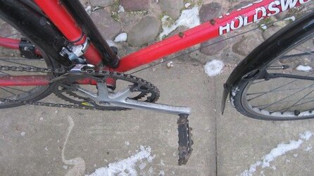

pedals and front mech
I'd firstly give that rusty bit on the chain stays/bottom of the seat tube a good clean with a wire brush and try and assess how deeply the rust has penetrated.
Other than that I'd be tempted to sandpaper out any other rust patches, pop a bit of Kurust on top and then simply paint over with red paint.
Personally the rear wheel hub looks to be on its way out (the spokes have started eating into the flange) and cassette look shot to me - with the latter it may also mean a new chain and possibly chainrings.
After that I'd take the chain off the chainrings and give the cranks a spin to see if the BB is still running freely- also check for any play in the cranks.
But sort out the top bit first because if the rust has gone too deep the frame is scrap - (it shouldn't have done as the 531 tubing was quite tough and thick in those days).

Well I have just gone out with a wire brush to check the rusted patch at the base of the seat tube, and luckily it seems that rust is only superficial. Very little rubbing reveals the shiny metal tubing underneath so I think that no permanent damage has been done at that it can be salvaged. Other that one patch there are not many other places on the frame that has rust on them, it only the QR where the rust has attacked it badly.
The comment about the cassette strikes me as a bit odd, they were replaced by the local bike shop when I got the bike as they needed to go because the teeth had worn out. He fitted seven new cogs and a new chain but the front chainring is as it was. I know I should've replaced it but I didn't think about that at the time.

Just be aware that rust can penetrate into the lugs, the braze doze not alway fill the joint 100 percent and they rot from the inside out.

Actually on the normal sized photo the cassette looks ok - it was the supersized pic that made it look badly worn.
If you go down the patching up route I'd just use some Hammerite (mix some red/white to get the approx colour) as this doesn't strictly need Kurust and will give a tough finish.
