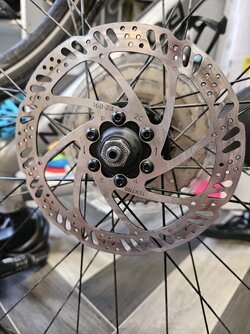

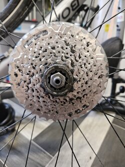

Here are pictures of both sides of the wheel

do I need any specialist tools to have a look at the bearings
So to service those cup and cone bearings, you need cone spanners (maybe only one) and an adjustable spanner for the lock nut (the hexagonal one you can see in the image). That's all.
Remove QR skewer.
Pull the rubber seal off, gently (there is a risk of a split).
Undo the disc side lock nut and the cone (which has two slim flats which needs a cone spanner, a normal one won't engage). Completely unscrew and remove both.
Do not touch the cassette end lock nut.
Extract axle from the cassette side, with the hub over a cloth, as lots of bearings may fall out.
Remove all bearings and count them (?11).
Clean everything - I use WD40 and paraffin.
Inspect the hub cups (where the bearings roll) and check still smooth.
Could use the current bearings but I'd buy replacements from my LBS (did this a fortnight ago) - v low cost.
Slap in grease, insert (stick in the grease) correct number of bearings, screw everything back up.
Tighten the cones hand tight and then back off 1/2 a turn, and lock (lock nut).
Refit QR and wheel into dropouts; tighten close QR and check the wheel spins and the rim can't be pull/pushed sideways.
(Keep in mind that closing the QR lever compresses the axle which is why the cone must not be tight.)
The lucky person gets this 'right' first time: most mortals need a reiteration or two.
Ride on.

sambo241
Regular
Wow thank you Ajax Bay for the step by step guide. Seems fairly straight forward enough to follow that walkthrough.Think I'll give it a shot and see how i get on and if it fails, take it to LBS.
Just for clarification, can the cassette and disc rotor remain on the wheel whilst i service the bearings or do I have to remove it in order to proceed?

Both can stay on but it will be a fair bit easier to clean the right side cup if you take off the cassette.
Tools needed: cassette lock ring tool (and an adjustable spanner to grip it), and a chain whip.
