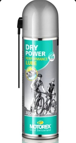

I asked my local Brompton dealer about their suggestions regarding rust protection. They told me to never use WD40 and use this one instead.
630222
Which is apparently a chain lube, but that's what they say will offer adequate rust protection. Lots of different opinions in the internet.
