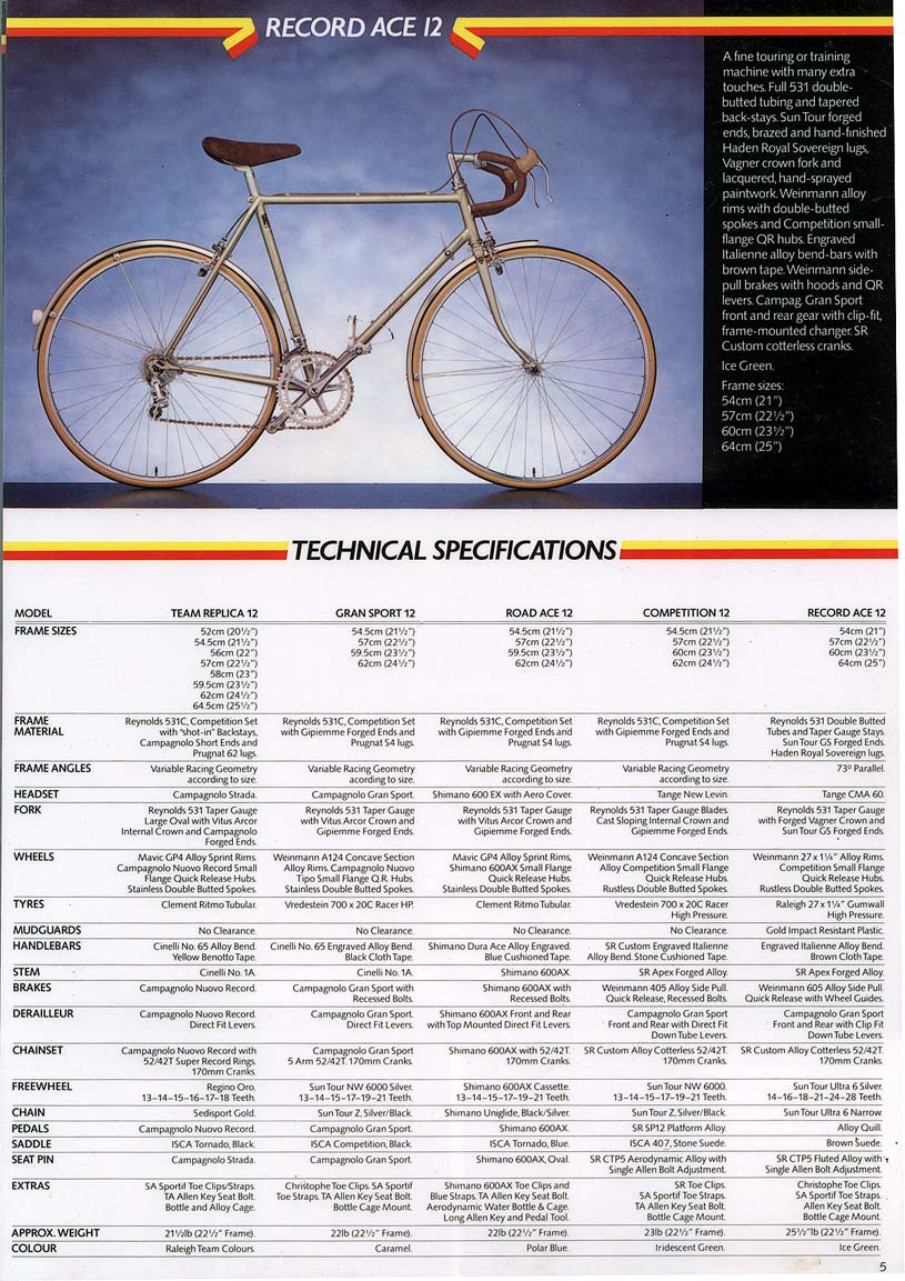

I recently won on 'bay a 1983 (I believe http://www.bulgier.net/pics/bike/Catalogs/Raleigh83/ral83_05.jpg) Raleigh Record Ace EX. I plan on posting the odd picture / story to document my progress.
My plan, is not to "restore" but to get it get it riding again. Although I love to see vintage bikes buffed to the 9's with perfect paint, I'm after the more used look. (read that as : I cannot afford a respray.)
