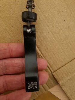

Two-Wheels
Probably 100mm front and 135mm rear being a hybrid.
How on earth do you measure these things?
Other sources I'd read mentioned 135mm too but this is the one that came out of the rear...
Looks about 180mm to me. Or maybe a bit less, 160mm, depending on your start & finish points.
Part number stamped on:
Been meaning to ask this all week but kept forgetting to get a photo.
