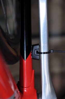

Active Member
Hope this helps.
As I see it I can either file off the sigma logo off the front or file away the plastic which currently moves it away from the crank. The only problem with the latter is that this would mean I couldn't fit it to any bike that needed the extension piece to move the magnet closer to the sensor where the chainstay to crank gap is large because the piece I would be filing off is the location lugs for the extension.

tnr319
Why don't you use a cadence magnet? Here's one listed on eBay 121182732705 I put one on my crank and it is rock solid. Remove the clearance issue in one go and they are really powerful.

Move it round to the other narrow edge of the crank. Magnet should be plenty strong
Sounds like a solution as even if I shave the provided magnet down to fit the gap the sensor fixing requires some space between crank and chainstay. If I move the sensor to the seat tube then the gap is too large and I need the extension to the magnet, which will then not go through the space. I could pack the sensor out but then the issue of rigidity and solidity raises its head.
Seems big old lump of iron may work, will check ebay.

Edge705
Rip the magnet out of the plastic housing and use strong clear/black tape to wrap it around the crank alternatively buy another magnet fairly cheap and do the same.
Yes I can see that is the way forward. However it is a shame that when you pay £88 (normal price about £130) you may be forgiven for expecting it to be designed to fit a "normal" bike.
