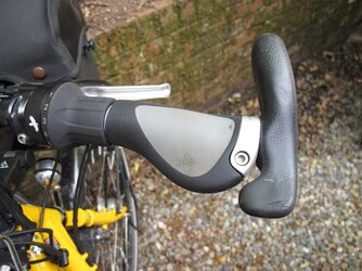

Regretfully it is one of these try it out and see things. Start with the stem & grips if you know your gloves are OK. They are easy (if fiddley to replace). The SJSC bar ends, add an extra 'pad area' for the lower palm, leaving a gap between the Ergon GP1 grip and the SJSC bar end which is where I naturally found my hands - great because that is exactly where the nerves that cause my issue happen to be. I'll try to get a photo to make it clearer....

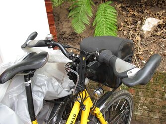

please click on image for larger view of my set up. It can easily be replicated on a MTB and I did have something similar, without the comfort handlebars.
My rather worn Ergon GP1 grips with SJSC's bar ends. (I needed the GP1 grips in small, my OH in large).
The Thorn Comfort Handlebars (overall view) with short/raised stem.
Worked well for me on 12 months of touring over nearly 14,000km (8,700 miles).
