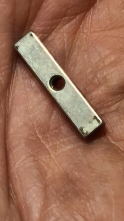

The old SRAM 6-speed has far closer ratios and I like it better, but spares are getting difficult for SRAM hubs now, and they do need attention more often than do SA hubs. The big bearing races are poorly sealed, their ball cages wear out and no longer retain balls (loose balls are not a good option in this instance), and axle keys easily snap.

SRAM hubs (...) do need attention more often than do SA hubs. The big bearing races are poorly sealed, their ball cages wear out and no longer retain balls (loose balls are not a good option in this instance), and axle keys easily snap.
Once more you do, as with many other things Brompton, seem to suffer from very exotic problems that almost no one else suffers from and clearly not in combination or to that extend. As the S/A 3-speed hubs the Sachs/SRAM hubs have been a construction that is more or less around 100 years old and pretty much bomb proof. There are probably millions of them in service and barely ever somebody has issues with it. I've personally ridden the Sachs Torpedo (which is basically the same hub) for around 20 years an my main bikes and never had any issue with it. After that I still had (and have) Torpedos, Sachs 3*7 and SRAM 3-speed hubs (but did not use them on a daily basis) and guess what: I never had any issues with them. So you really seem to attract bad lack as barely anyone else does...

No, it's because people never service them and assume the gummed-up feel is normal, or do a very low mileage.
The axle keys are more likely to snap if the gears are changed down when stationary, but can go at any time. It immobilises the bike if it happens. The hole is too near the edges of the key.
