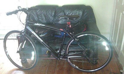

My new bike arrived today, took it for a short spin...... wow.!!!!
Very happy, cant wait to try it out over the weekend.
Thanks to all for your advice...I'm sure I'll have many more questions.!!!!!!!
