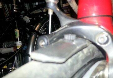

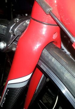

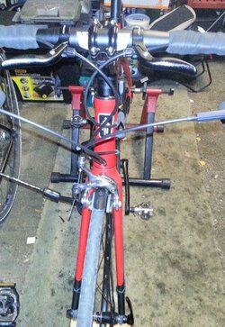

Managed some not brilliant pics - but they give you an idea of how tight we are talking and also of what the Cruds look like. I trimmed about an inch off the front guard as it rubbed on the wheel at full length.

Got crud road racers mark 2 on mine. Takes a lot of fiddling to get the front mudguard setup right (took me a whole afternoon) but doesnt rub except for high speeds on very bumpy roads. If the tip of the front mudguards are rubbing then I found that the cable tie around the front brake caliper needed to be loosened slightly as it was forcing it down.

I found that on the original tyres the Crud Mk2s rubbed on the front tyre which necessitated removing the piece in front of the brake calliper. I've since changed to Michelin Pro Race 3s which are nominally the same size but don't cause rubbing so the front piece has been reattached.

FWIW I bought some SKS Chromoplastics in Black 700x20-28 - Narrow (http://www.wiggle.co.uk/sks-chromoplastic-road-mudguard-set/) and they fitted OK. The limitation on the front was the space around the inside of the front fork - the welds prevented the mudguards from being pushed up too far so it may be required to take a small nick out of them for added clearance but I didn't find it necessary. Back mudguard fitted without issue. Perhaps a bit fiddly to assemble but very secure once everything was tightened up. Some cropping of wire struts is obviously required. I also had to cut a bolt down that was a bit too long for comfort on the back as it stuck through the frame.
