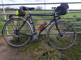

For reference, here are the two bikes (click for bigger image), both get used for four-pannier camping trips as well as pottering around country lanes; the plan is to use the Rove a lot more off-road and avoid the traffic.
Thanks - those look like a nice versatile pair :smile:
