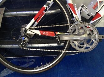

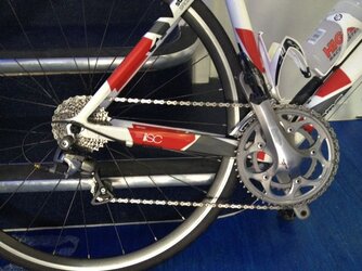

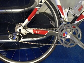

Just some photos showing gearing in different positions, hope this helps...or am I just being paranoid:
Big / Big
Small / Small
Small / Big

You've got a lot of capacity left in the big-big combo. I'd pinch 2 inner links together on big-big to see if you can remove a pair of links like the top section chain below.
GrasB
Nr Cambridge
For non-racing use I prefer my chai to be as long as possible, so I'd only take out the links you need to maintain tension on small/small. The reason of this is so you have as much chain as possible for sorting out a broken chain in-ride.
For race day bikes I run the chain as short as possible, this improves the mech's chain tension control & thus shifting in non-optimal conditions.
