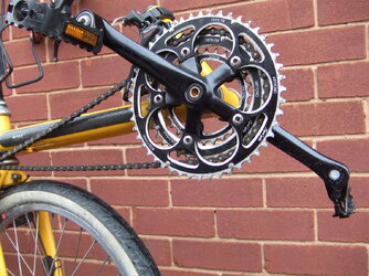

https://www.littlethetford.net/?page_id=529] is worth a phone call and can supply nylon idler wheels and handlebars which he has made. If based in London Bikefix can help with possible servicing. Theres any number of set ups of the front derailleur; i have a triple chain ring set up; and 7 speed rear derailleur. They have different handlebar gear changers, twist grip or trigger shift. Once you have had good look and assessed what you have you can start to make improvements. The best thing I ever did was get smaller nominal 17 inch 32-369 17 x 1 1/4 from a Moulton set up... as the Kojack tyres are good and available. The seat set up can have problems; its a tension based strap... which can dissadjust itself; I have solved this by using a seat cushion from another recumbent like this
